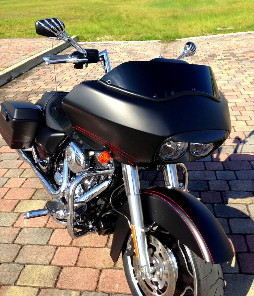

I'm on my second bike with matte black, and I've also painted areas of my car with it as well.
There are a few different ways to achieve the matte look, discuss your options with your painter.

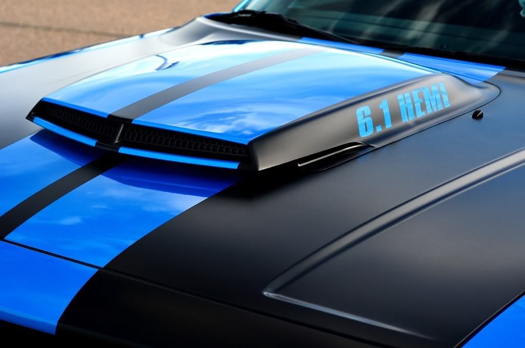

On the hood of my car, we used "Hot Rod Flatz", which is quite different than the matte clear used on my bikes. I like them both, but for different reasons.

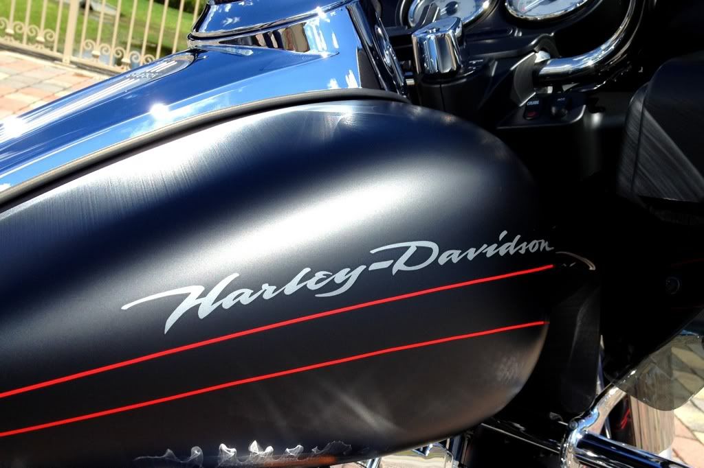

If done right, the surface will be perfectly smooth, NOT rough feeling.
It is true that you cannot rub or buff the surface at any time because it absolutely will cause that area to get shiny.

I have used S100 on paint with multiple layers of clear, I have used it on a special matte paint called Hot Rod Flatz (this is the kind that you CANNOT wax), and I use it on my Denim Harley paint as well. My previous bikes did not have much chrome, and my black engines came out rich black, not grey or cloudy. My chrome on the RG comes out sparkling without polishing or buffing or special compounds.

About every 3 or 4 washes, if I really want to make it look like it's rolling into a show, I will use a light application of Maguires Spray Detailer and a microfiber cloth. The ONLY time a cloth will touch any of my paint is after a complete and thorough wash, so there is no risk of dust or particles on my paint which will get rubbed in and scratch my finish. On my RGC I am using the HD Black Denim spray, lightly, and it seems to work very well. I use it mainly for touch ups between washes though. I've yet to feel the need to spray down the entire bike with it. Mainly my fairing and tank after a few long rides between washes.
It takes me half the time that it takes to do it "the old fashioned way" and my bikes always look showroom new when I am done. When I sell or trade a bike I am always asked how my paint looks like new, with no swirlies or other common issues... this is my secret.

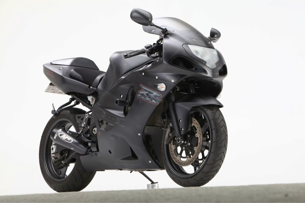

My old Gixxer that I customized. That's a $10,000 paint job
