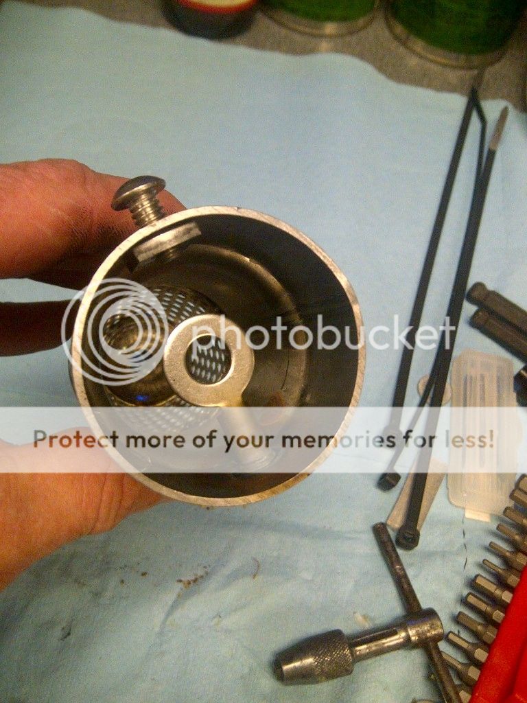

Originally Posted by SilentUnicorn View Post
Couple of pics of the baffles I have installed in my shotgun pipes. Initial results sound great. They definitely took some of the harshness and crack out of the sound. It will be a bit before i can get it out on the road to really test them out for performance.
m
Here is the Thunder Monster QQ Baffles mod I did for a customer on his 2011 Cross Country. Video has a before and after mod.
Sounds Freakin Awesome.....

Originally Posted by ridinman View Post
Noe,
You said you did the baffle mod for a customer, did you modify stock pipes, gutted stock pipes or ???
I'm trying to achieve something fairly quiet, but still with a deep thump. I liked the after mod clip.
We have done several versions. We start by gutting stock pipes. The Magna-Flow Mod is basically retrofitting a set of their factory fabricated glass packs in to stock muffler housing. Then welding everything back up. The Thunder Monster set up is a bit different....we make a custom length pipe and attach the TMB exactly 12" into pipe for the creation of optimum echo chamber sound. Then weld everything back up. Both sets will bolt right up using stock hardware an heat shields. In both mods you can use your stock tips as well. Both sets have been working very well according to customers, but we do not have access to a dyno so we have no numbers. The Magna-Flow is a little quieter at idle, but both sound and respond fantastic when throttle applied. Of course I always recommend upgrading intake filter and tuner for optimum performance. Hope this helps......and If you need anything....let me know.
