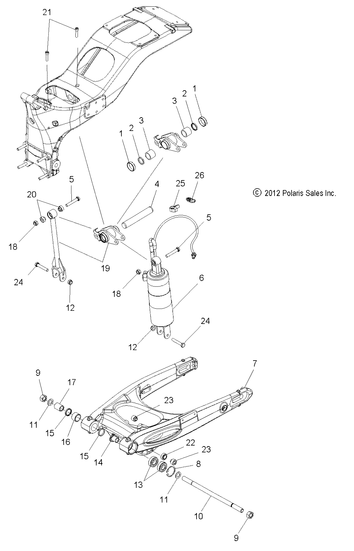

Originally Posted by TheMike View Post
That makes sense. That would mean then that the Ness rides stiffer than the non-Ness sort of speak?
I think you've got it. I was looking at the two different models and they show the same travel but if the Ness model is lower via the linkage or a shorter shock then the trade off is a stiffer ride.
2013 Victory Vision Tour
2013 Victory Arlen Ness Victory Vision
But then I did a cross reference search on the the two and now believe there was a change in how the suspension works starting in 2011 so if you have or can get a 2011 service manual; it might show the length of the shocks as being the difference.
The only difference between the two are the shocks starting in 2011. It appears before that they used the rocker to change the height.
So, to go to a stock rear suspension, the shock would need to be changed if I'm right. Two inches is quite a bit so I'm assuming a lowering of the front had to happen too to keep the bike stable and within spec. I didn't look into how that was accomplished but I did see that there were 45mm and 46mm forks in earlier years but in the 2013 model year they don't mention it meaning it is all the same regardless of whether it's a Ness or non Ness Vision.
61542903Shock, KYB, Air
61542904Shock, KYB, Air [Ness]
Click on the little shopping basket above to see the complete parts list.
By the way, just so you know, the frames of the X bikes and the Visions are not the same. They both use the core frame technology but they are not interchangeable.
Also, I looked up the cost of the stock shock, and it shows them to be $525 before any discounts and $414 after. Not long ago Victory made all their distributors stop showing any discounts online. You can contact them for a discount via email though. Kate from Honda of Toledo is a favorite on this forum.

You've done and wrote up exactly what I did earlier. You did the same research too but when I started I started with the '10 (I believe) service manual, which did show the different shocks and clevis/rocker. Now I know that's not the case for my '12.
Many have thought the "bone" is different or that's what could be changed out to gain height. That might be true but if that is an acceptable method I'd be curious as to why that wasn't the way Victory lowered the Ness's. There must be a design or performance reason. Another member here was kind enough to PM me with an extremely knowledgable person's contact info to question. I plan to do that tomorrow.
Aside from opinions and aftermarket input, it does APPEAR that the SHOCK/Spring Is the component that Victory uses between the two models for the different heights.
Edit: I can't see any differences in the front suspension, from any source.

This just keeps getting better and better. I found after I searched again the part diagrams for the FRONT suspension components, the cartridge, spring, and the forks are actually different between the Ness's and Non-Ness VV. Your assumption was correct that the front ends are indeed different too. Damn!!!

I'll let you know. I found out this morning that it IS just the shock that's different in the rear. But discovering that the front internals are different too I may do nothing. I will install the hitch this winter and see how it all works with just adding more air.
The dog bones appear to be the same across the models, it is only the shock that changes. Interestingly, the Ness is the same as the old 8 ball shock. The diagrams don't show it being shorter, but it must be if the bike is lowered and the dog bones are the same.
I read somewhere that the force per mm of shock compression was considerably higher on the Ness version. One would conclude it is a much stiffer shock, presumably to prevent it from bottoming out since it has less travel.
What was different in the front end, springs / spacers?
The cruiser models use coil spring shocks and most of the new ones use a "lowered" shock compared to what was used on the Kingpin. The lowered shocks have a lot stiffer spring and/or damping components in them too. The new cruisers ride very stiff compared to the KP.
