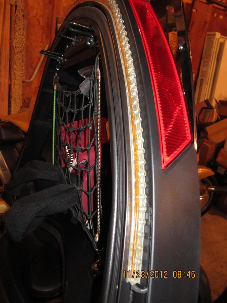

My mod uses a Kuryakyn 4710 module which connects the trunk lights to the bike's run, turn, and brake lights. I then found on Amazon 2 (two) 19" red LED strips. They're run one to each side so they work independently.

These are the LED strips I used. Click this Amazon link.
http://www.amazon.com/DEDC-Waterproo...=5336105930-20
They come from China but took 9 days to arrive. Better shipping time than ordering a lot of stuff from here in the states. Price was $6.49 per strip. They're only 1/4" wide so they easily fit in the lip under the trunk lid and the lid still closes fine without hitting them. These LED strips are very flexible and easily form to the shape of the trunk. When the bike is sitting and the lights aren't on you barely notice them because they're in the trunk lid gap. These LED strips are each 19" long so they each go from the center of the rear of the trunk to about 3" in front of the trunk lights also giving good side light addition. If you don't want your lights going along the side as far, or if you want you lights to extend farther around the trunk the company has other links. I wanted the side lights but didn't want to go too far where red would be showing to the front so I went with 19". I think they have them as short as 4" if that's all a person wanted.
Where the wires are run are at the front end of each strip. Where the 19" strip ends there's a slight gap in the trunk lid and inner lining. I used a 4" piece of shrink wrap over the wires at the base of the LED strip wires to give it a bit of insulation where it would run in the trunk lid gap. The wires are pretty fine gauge. Then I just connected the LEDs in to the existing trunk light wiring. When doing this make sure you connect the wires correctly or the LEDs won't work. If you connect them backwards they won't work. Just reverse the connection. The red striped LED wire goes to the hot side of the trunk light.
I went to OReilley's and got a package of 3M double sided tape. It's 1/2" wide so I cut it in 1/2 making 2 1/4" strips. I mounted 1 1/4" strip on the top of the lip and the other strip on the back of the lip. That way when I mounted the LEDs they are attached on 2 sides. Before installing the 3M tape give the trunk lip a good washing with soap and water and then a good wipe down with alcohol to make sure it's clean. When the 3M tape is applied it's stuck for sure.
No other bulbs are needed. The factory trunk bulbs are stock. It appears the way the 4710 module works is it cuts voltage to the lights in the running mode so the lights are just slightly dimmer than factory. Not much and can't notice it really. Then when you use the brakes or turn signal it uses the normal 12V which brightens the lights. Only way I can figure out it brightens them.
Here are what the LEDs look like mounted.
