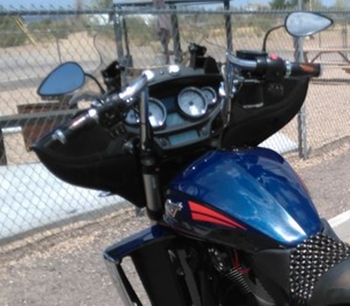

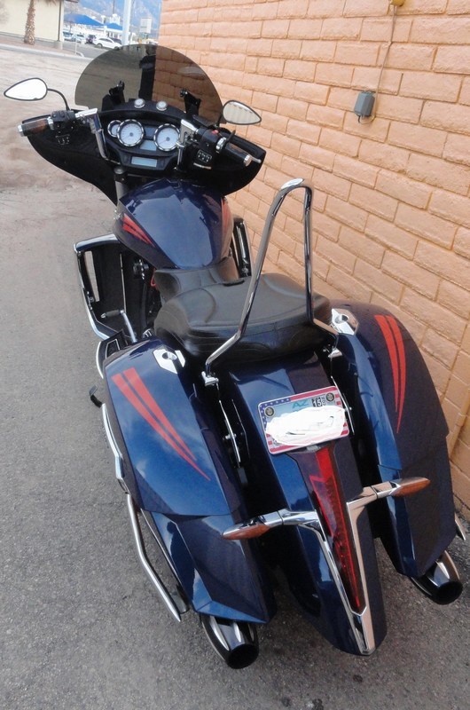

My 2011 XC worked fine with +2" bars. It wasn't until I went higher that I had to get a hose made using the existing brake line ends. Probably should have made them longer than +4" because it's a tight fit. A +5" or even +6" would have been better. Going to some Victory mini apes so it won't be a problem then.

These are +2" Ness modular bars with the stock line.
These are +4" with an extended line.
