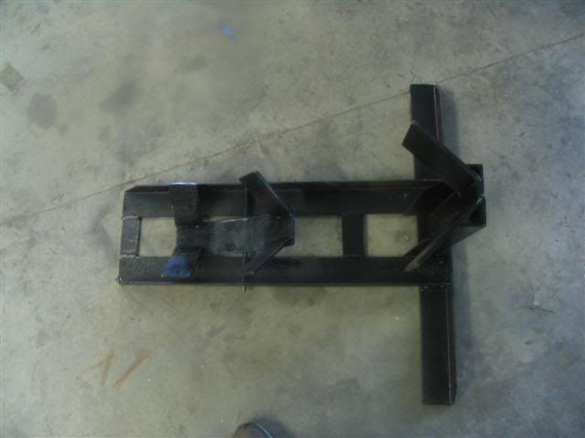

My chock was copied from the condor. The only difference is I raised the angle of the tire ramps. This raised the tire and fender away from the tire ramps.
You need to realize the tire ramps are designed to fit different size tires, height and width. This would make it difficult to get a accurate measurement. So the tire can be raised or lowered depending on the tire size. It happens that both bikes, XC and the bike I made the chock for uses the same front tire size. You can also adjust the ramp forwards or backwards this can allow the rear ramp to be lower. Just remove the rod with locking pin and move the ramp forward to the next hole. This will lower the rear part of the ramp. This maybe all you will need to do. I added extra holes for more adjustments. Once you move the ramp make sure there is enough pressure to hold the bike on the forward stationary post and the ramp will more forward enough to lock.

When you put the front tire in the raised position does it not raise upward? This is cause by the off set of the chock, it is not centered. Measure the distance from the pin to the end front and rear and you will have 2 different dimensions. The off set is what causes the the lock to work by pressure form the rear ramp when it is in the froward position.
Least wise the condor I copied did.
Mine
Cost was about $20
