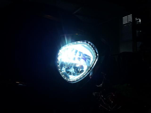

Sand Man, I just completed this install this evening and I have a 6K HID LOW/HI setup. I don't have my cable to my phone our I would post a pic. IMO it doesn't look bright as the HID' and you don't see them. I purchased two kits so I may go in and add the other one. I tap off the Low beam bike wiring which is Pink/Yellow (+) BLK (-).
If you haven't started yet try and place the led strips close to the edge of the headlight as possible. I had mines sort of in the middle. I hope that helps.

Sand Man, I readjusted the light strip by placing it closer to the edge on the glass itself, I also had to change the orientation of the light strip because I had it backwards. Also when looking at the pic on the instructions just insure the flat edge of the led's are facing out, as in front of bike. See pic this is after making the correction.

This mod looks pretty good. It reminds me of the new cars coming out with the LED running lights in the main headlight.
