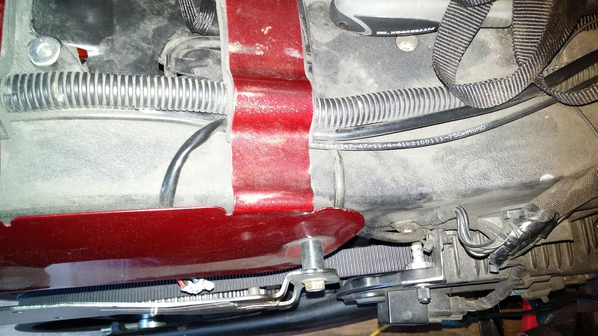

Anyone ever find the air hose for their rear shock wearing though? I pulled my seat and noticed a significant(through the outer sheath) spot of wear, where the air hose comes over the wheel well. It looks like the seat is rubbing on it at that point. I'm glad I caught it now, before it split the hose.....I think I can salvage it, then reroute the hose.
Any suggestions on how to fix the hose, its not fully though or leaking and where to re-route? Thx

Posts: 4,046
I was thinking about it, but instead I patched the hose and got it out of harms way.

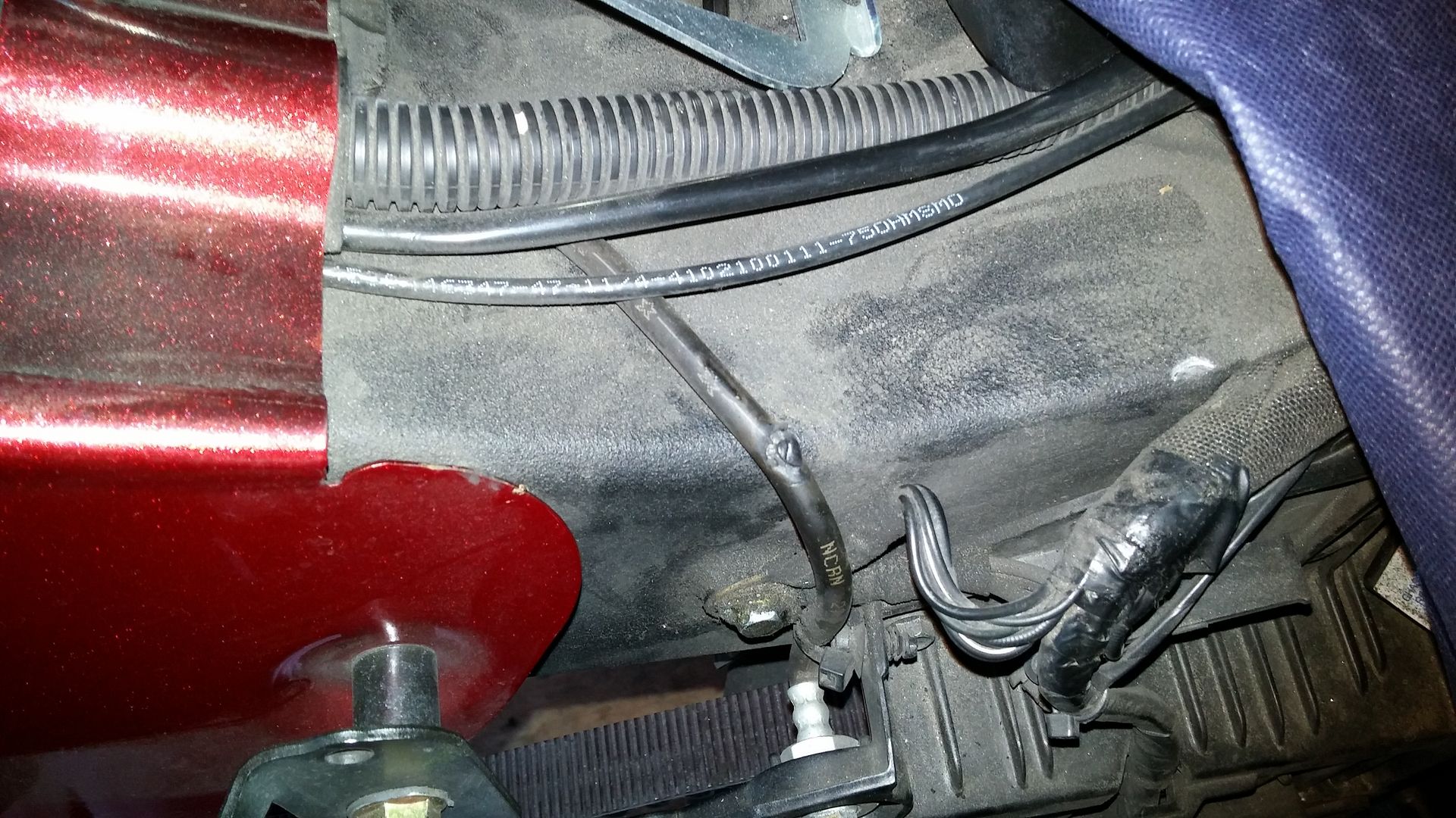

Posts: 4,046
for your viewing pleasure here's a pic of the repair on the hose:
