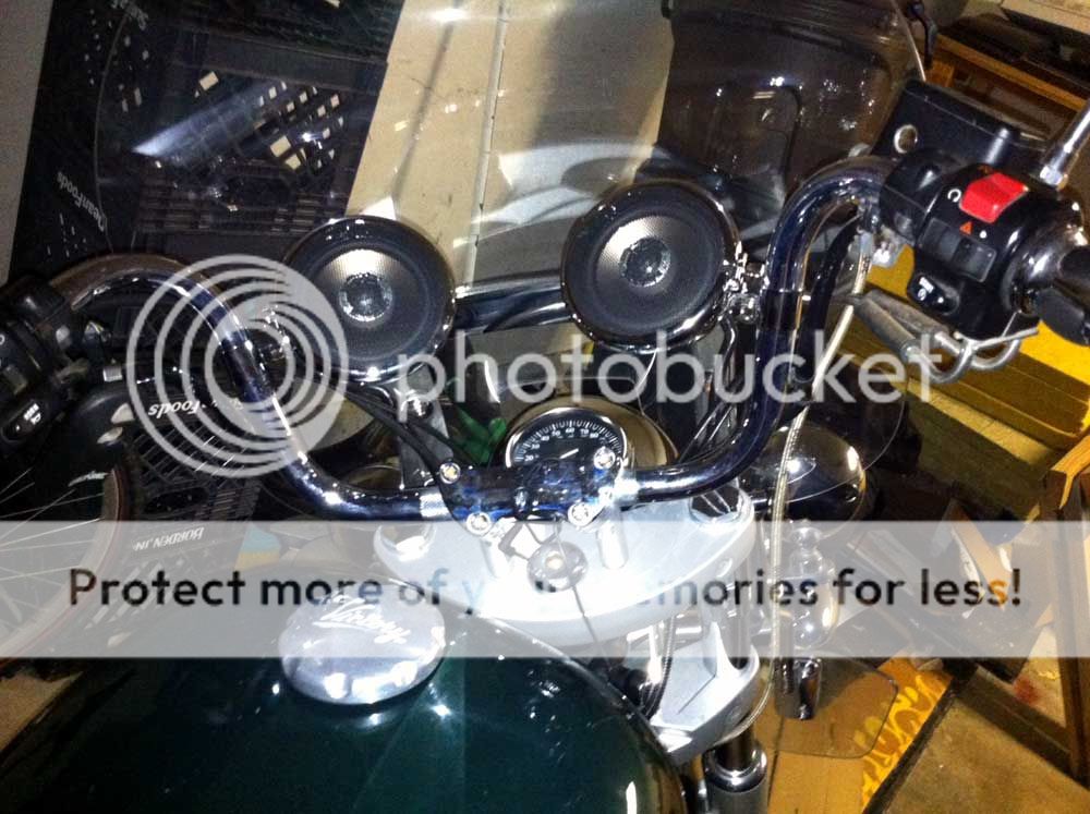

Here's a shot of the speakers. Not really much to see...which is a good thing. Wires run up under the gas tank to behind the right-side panel cover, where the fuze box is.
Amp is mounted to the frame under there. Even though it's a waterproof amp, I didn't see any reason to expose it to rain purposely.
Oh yeah...got this system from motorcycletunes.com
This is the Polk audio system with the 600w water proof amp. Came with speaker clamps and all the hardware necessary to install. Plenty of wire to get things where you want them. In fact, I cut off about 4 feet of excess speaker wire. Note...it didn't come with any zip ties or anything to secure the wires to the frame.
