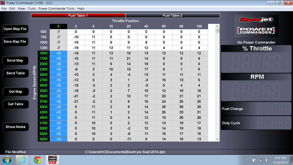

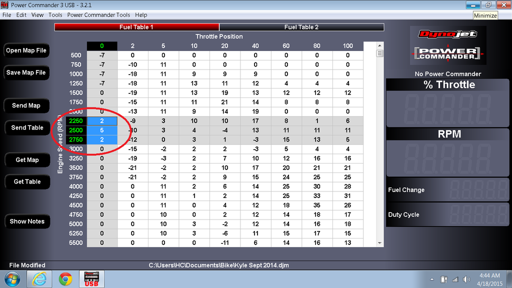

Figure out at what rpm the popping occurs on decel.
In the power commander software, in the 0% throttle column, put a value in that cell.
The 0% throttle column should have all zeros above idle speeds. If it is popping at 2500 rpm, put a value in that cell and the ones around it in the 0% column... like this...
Start with low values 2-5-2. If it still pops use 5-10-5 etc. If you go past 20 and it still pops, put -12 (minus twelve) in those cells.
If it is popping all over and on shifts, put -12 in all the 0% cells above 1500 rpm.
It probably would be a good idea to reset the throttle position in the Power Commander too.

I don't believe there is a leak, I know everything is tight. Plus it only started after the change over to the PCV
I've only had and hour on the bike since the install and the mapping seems excellent, other than the new popping. I can't be very specific, I'll have to pay close attention this weekend as to where its happening. But I notice the pop most when I up-shift from 1st-2nd and 2nd-3rd in my "typical riding style" where I shift around 2800-3000rpms
As I said in the OP, I used to get popping with the O2 sensors disconnected. Now that I've slept on it I realize, back then it was much more severe and a LOUD backfire(probably scared the shit out of a few cagers in traffic ). The popping I'm getting now with the PCV is very minor by comparison. Since the PCV cuts off the O2 sensors I'm sure this can be taken care of with a tweak to the map.....which was the answer I was looking for.
