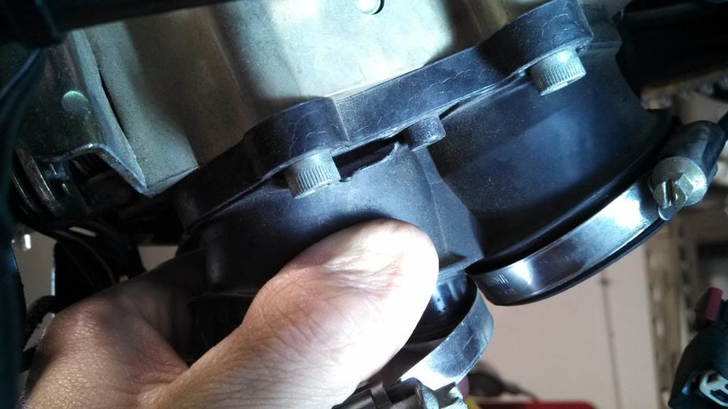

upon close inspection today, i noticed that my rubber throttle body adapters actually are cracked pretty badly on the upper side where they mount to the TB. i'd rather not pay $80 bucks for one if i can cure the problem with black RTV. has anyone else done this?
this also explains rough idle and hesitation while rolling on the throttle slowly i guess.

You know your going to try thr RTV so try it. In the mean time order the parts and have on hand when the RTV doesn't work out

I suggest trying to squeeze any large cracks closed while you're putting the rtv on. I learned the had way that your engine isn't happy after sucking rtv in. Note that my experience was on a 2 stoke dirt bike and a blob of rtv jammed the reed valve open.

Even though they appear cracked (and can eventually crack through) likely it is surface cracking. If the bike isn't running funny from a vacuum leak caused by being cracked all the way through then I wouldn't worry about it and just silicone them up.
I've worked on many bikes over the years with cracked rubber intake boots like that. 95% of the time I don't replace them unless owner requested.

It stammers at idle and hesitates when slowly rolling on the throttle at cruise speed.

$80 bucks is cheap. A cracked throttle body on a stock motor isn't great but having one on a built engine is really not great. I didn't know mine was cracked because the bike still ran pretty good. One day last summer, it scored a cylinder from running too lean. That was only a $3,500 mistake.
Don't cheap out. Replace it.

I definitely know the dangers of a lean condition, but I'm confident that black RTV will repIr the issue fine.

Ah, I was thinking "cracked" like "dry clay." Like spiderweb cracking from age and heat. That's what I would call "busted."
But right on the silicone. The intake pulls so little pressure in reality that the silicone should hold. Personally, I'd replace one that's torn like that but a quick cheap silicone try can't hurt.

Im about to pull mine off and see how badly it's split.
