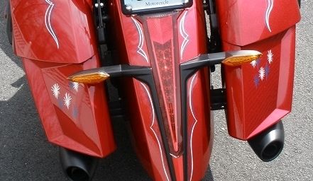

I bought my XC with custom pin-striping done by the previous owner. For the most part I like the strips but the stars bursts or whatever they are are not growing on me and I've had enough of the comments about having "flowers" on my bike
I'd like to cover the star bursts or best just remove them all together. I thought of having them done over in black. Anyone have any other artsy-fartsy thoughts on what to do with the star bursts?
Any ideas on how to remove the pin strip paint without damaging the factory finish?
Here's pics of the star bursts:

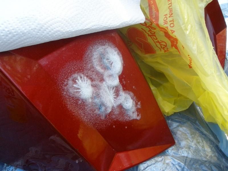

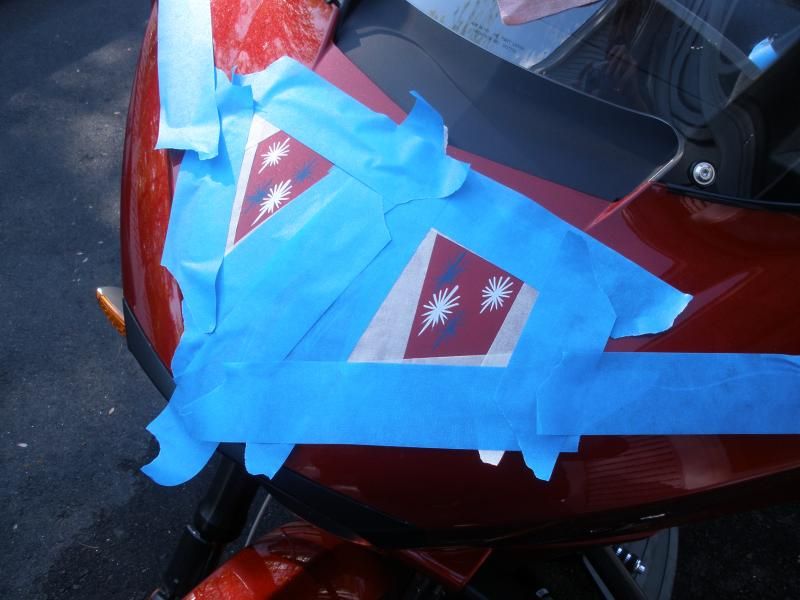

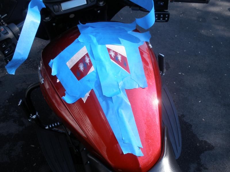

It worked perfectly and cleaned up real nice but removing the stripes does take many spray & scrub sessions. I ended up removing all the star bursts and also the tank and fairing pin stripes, just left the fender and bags with them on. The bike is much less busy now with no "flowers"...The things bugged me and now with them off I realize how goofy they actually looked on this bike. I'm very happy with how this turned out.
The previous owner also epoxied something to the clutch cover that fell off and left the glue, I decided to fix that while I was at it(that's the tape/drape seen in the last pic).
Here's the process
