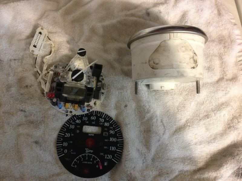

I took a closer look at my old project and you can access from a door in the back to change the bulbs and if you look at my spare speedo on the right you can see the piece of material that covers the holes in the bottom of the case, I remember I trashed the metal bezel taking the front glass off trying to get to the faceplate-it's not meant to be removed and looks to be crimped into place with the gasket between it & the glass- I'd be more worried about the electronics than the glass but there's not a hell of a lot you can do.

The speedo housing can be accessed thru the back if you have the proper toll and some skill at plastic cutting... I carefully cut thru the case towards the base and was able to disassemble the unit from there and dry it out, reseal, and then weld the plastic back together... MUCH MUCH easier to buy a new unit.
