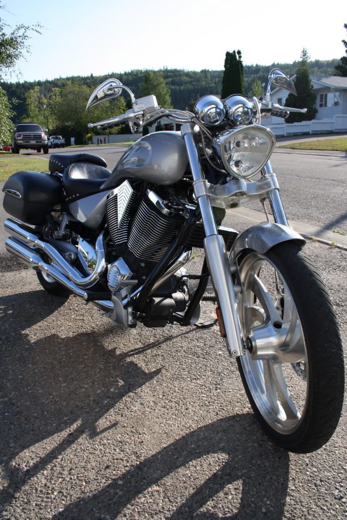

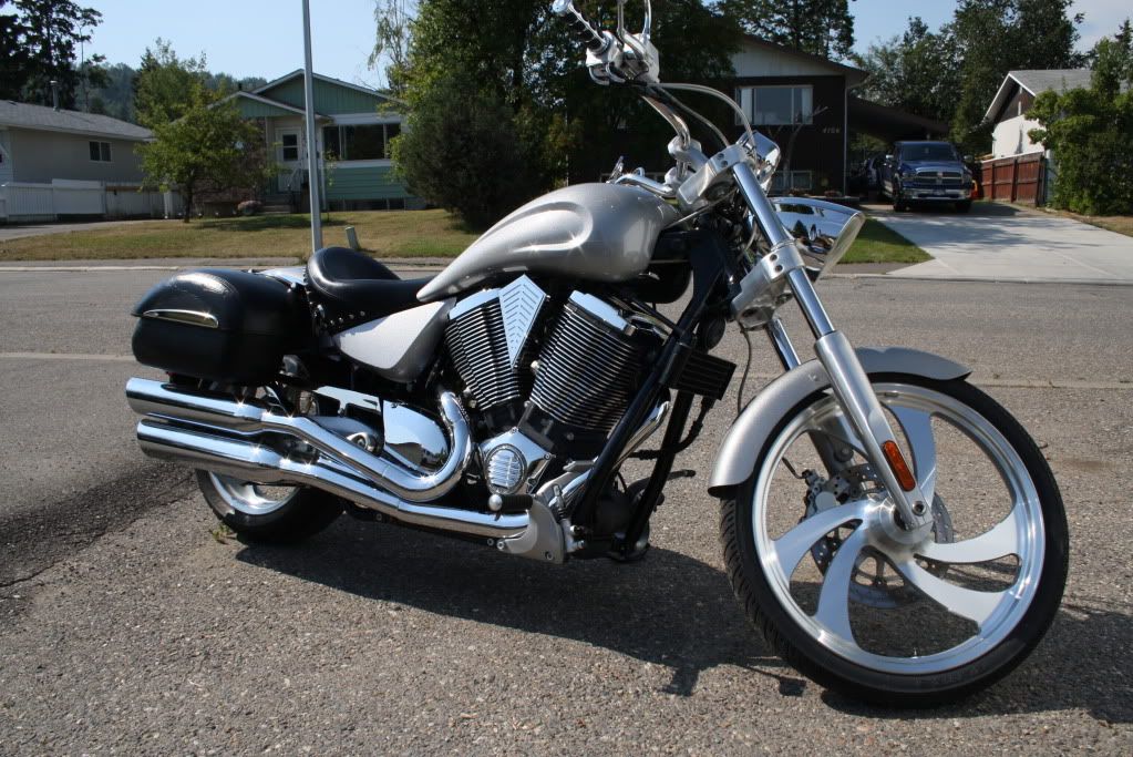

Since there is a link to this thread in my signature I'm keeping it going. Two weeks ago I did some more work on the bike. Here it is now with Victory Comfort Grips (Kuryakyn ISO Grips, same thing apparently), Arlen Ness Rad III Mirrors, Crossroad's HID kit and a stainless steel braided cable set. I've got some MBW LED turn signals on their way from Victoryonly.com which I will be installing next. When I do I plan to build a custom licence plate mount for the rear fender rather than buying a side mount. When I'm done I'll post more pictures.

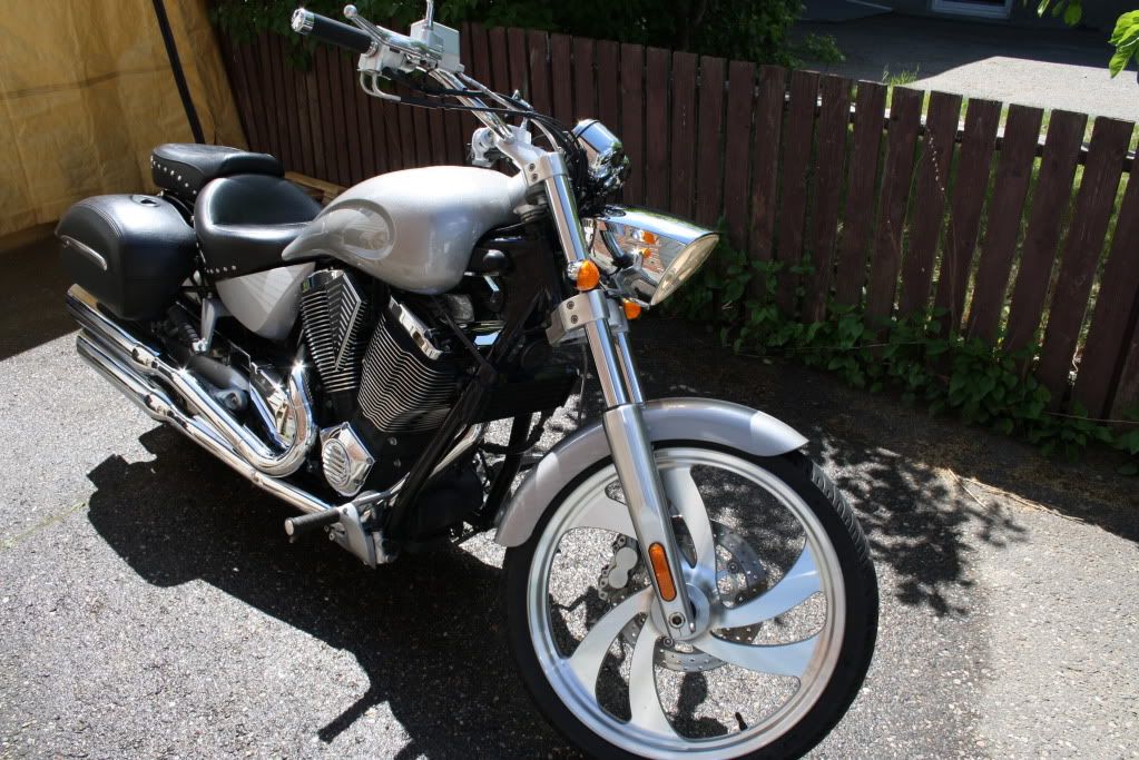

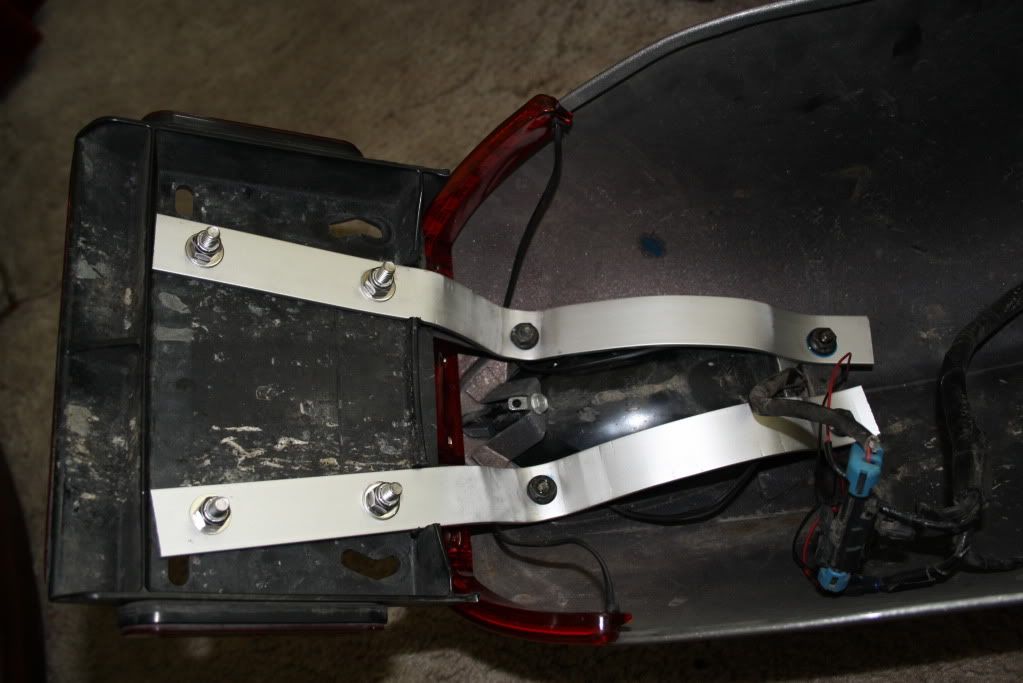

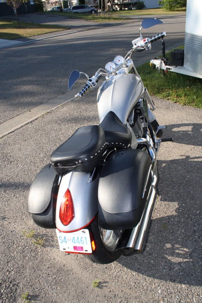

I think I'm done now. This weekend I installed a set of MBW LED turn signals. Although I am having some issues with the Load Equalizer everything else turned out extremely well.
In order to keep my license plate where it was I had to cut the plastic mount off and then DIY some aluminum brackets.

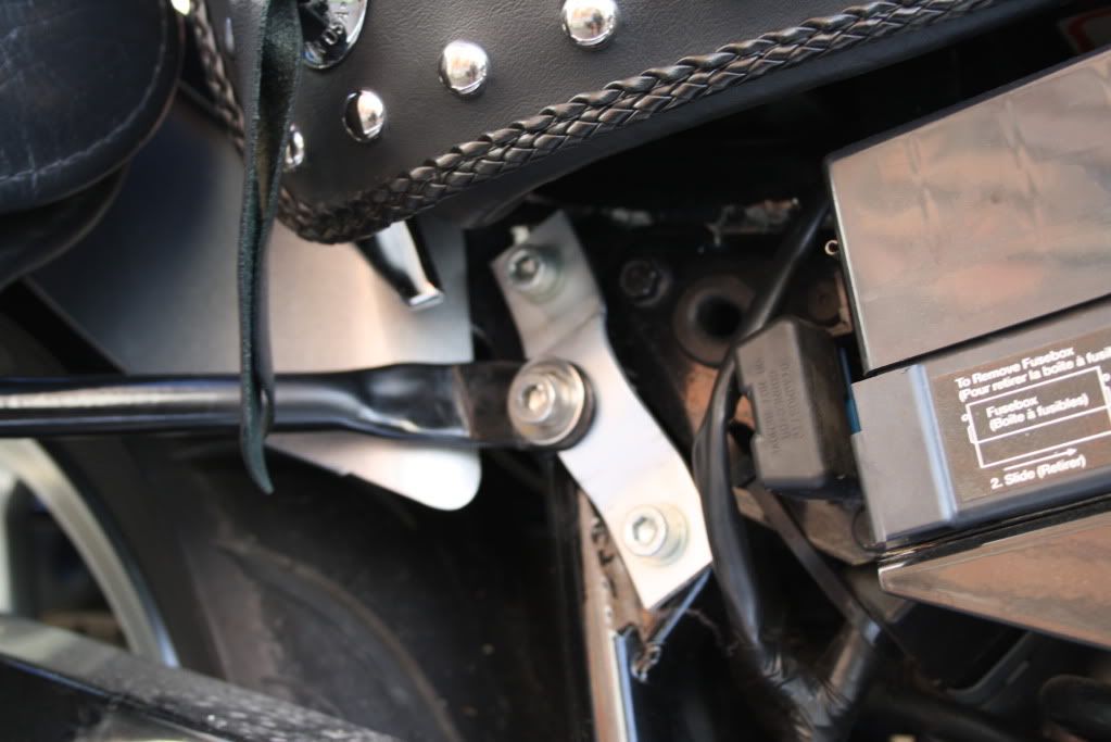

On a side note, I removed my passenger seat and footpegs last weekend. I've been riding since 2006 and I've never carried a passenger. I would have taken them off sooner but the mounting brackets for my saddle bags partially bolted to the footpeg mounts. So what I did was bend some more 1"x1/8" aluminum to make some new brackets for the saddlebag brackets to bolt to... sound confusing? Look at the picture.
