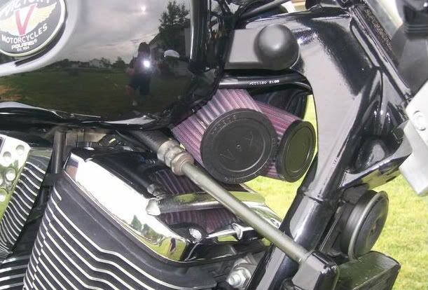

My local Vic dealer tells me that i would get quite a bit more performance on my 06 Hammer by installing an S&S breather. I have slasher pipes that came on the bike. The install would be about $600.00 with a new flash card. I am told I would get considerably more horsepower and performance, though my bike has a K&K filter and what I believe is a stage one card.

I have RPW slash pipes, should that make a difference to any reply posts.

The S&S is worth a dozen HP.
Stage 1 was 81 HP. With RPW Slash pipes, the S&S, and a VFC my 2006 made 93 HP/105 TQ to the tire.

either a cheap ness or fancier lloydz or S+S air cleaner will let your bike breathe, the K+N is a joke IMO way too small. my 13 hammer had one that came with the dealer tri-pro + dealer tune. seems expensive though, i installed my air cleaner in 2 hrs being fussy, a pro should take an hour or less, S+S is under $300 not sure about the tune card cost.
