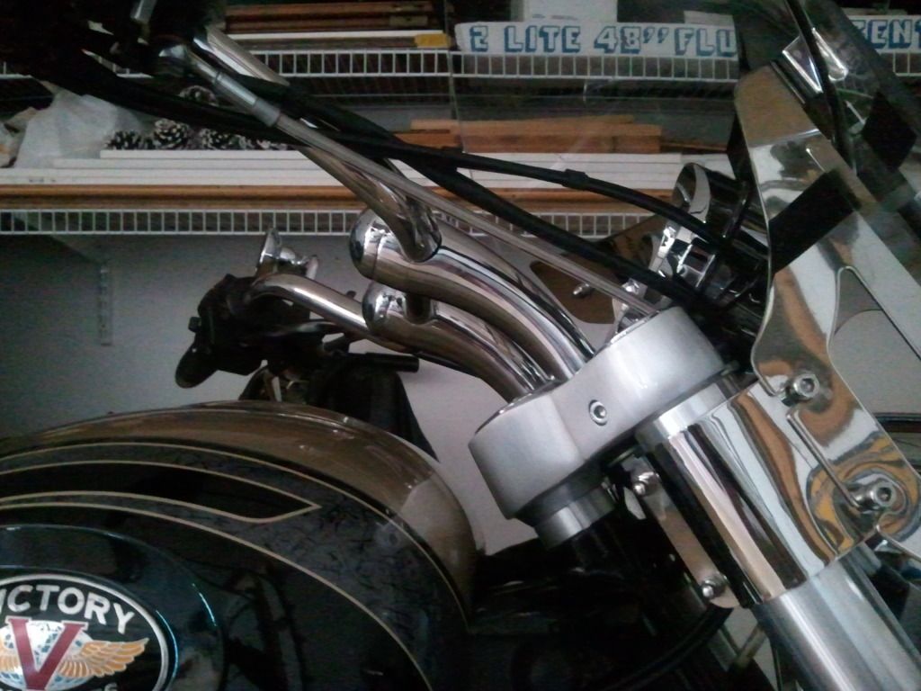

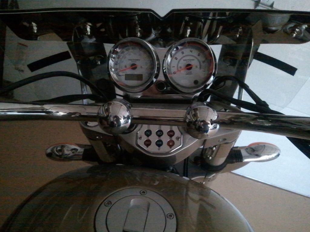

I found a set and installed them this weekend. Not Victory specific but I think they look good:

Found them on eBay, and they are not Victory specific. You will have to get 2 1/2"x13x3" bolts. I bought 2, 1/2"x1-5/8" chrome washers for under the riser to hide the rubber bushing and used blue locktite on the bolts.

Originally Posted by ljurgens View Post
Probably, I just make sure the diameter at the base of the riser is not larger than the opening on the triple tree where the riser fits down in. I see they mention the bolt sizing you'll need on that page as well.
Did you need to get longer control cables?

For the ones I got, I did not. I did need to pull the power cable out of the metal spring that holds it near the speedo to get full turn to the right stop without binding. Otherwise everything seems fine.
So, how far did they mover your bars from stock? closer? Higher?
