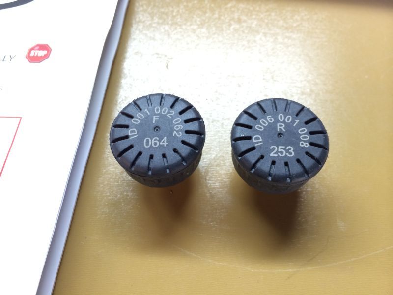

The kit comes with everything you'll need for the install:
The actual tire sensors can be installed on the exterior of the wheel, or the interior.
I didn't want to take off my tire just so I could install it on the interior of the tire, so I decided to just install the sensors on the exterior valve stem. They just screw in, it couldn't be easier, and they do not interfere with anything.

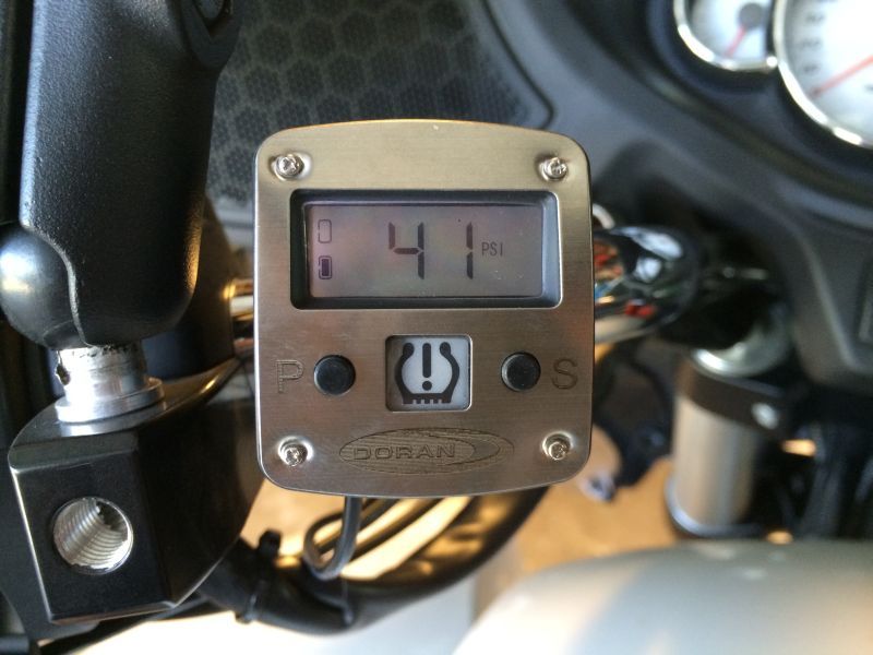

The next step was to find a place to install the actual monitor. I mounted it on the left handlebar using the mounting bracket and rubber handlebar spacer they provided. The monitor itself is small, out of the way, yet still easily visible:
The next step was to wire the monitor for power. I ran the wires through the fairing, and into my Fuzeblock which I already previously installed on the bike. I set it to the "always on" position, so I don't have to wait for it to connect to the sensors upon every start up:
All powered up:
The last step was just to program the sensors and "pair" it with the monitor. This was a very simple step and just involved pushing a few buttons, and entering the numbers from the sensors. The monitor then recognizes the appropriate sensor and is now constantly monitoring the tire pressure for the front/rear.
Now if I want to know the current tire pressures, I literally just have to walk over to the bike, press one button, and it will display/scroll through both front/rear pressure readings. It's so much easier than the old way of having to get down on the ground to try and check the pressure using a gauge.

Oh, one more thing I forgot to mention...
The little monitor display is LED backlighted as soon as you press the button, so even if you're riding during hours of darkness, you will still be easily able to see your readings:
