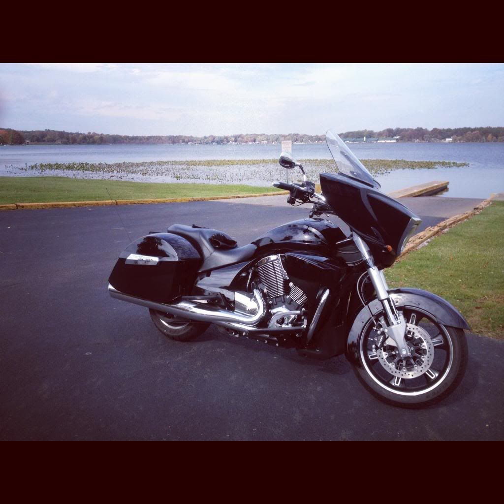

Well here is goes this is my 2012 cross touring. I purchased it new in May 2012. I had D&D mufflers installed and pull back bars installed before I picked it up

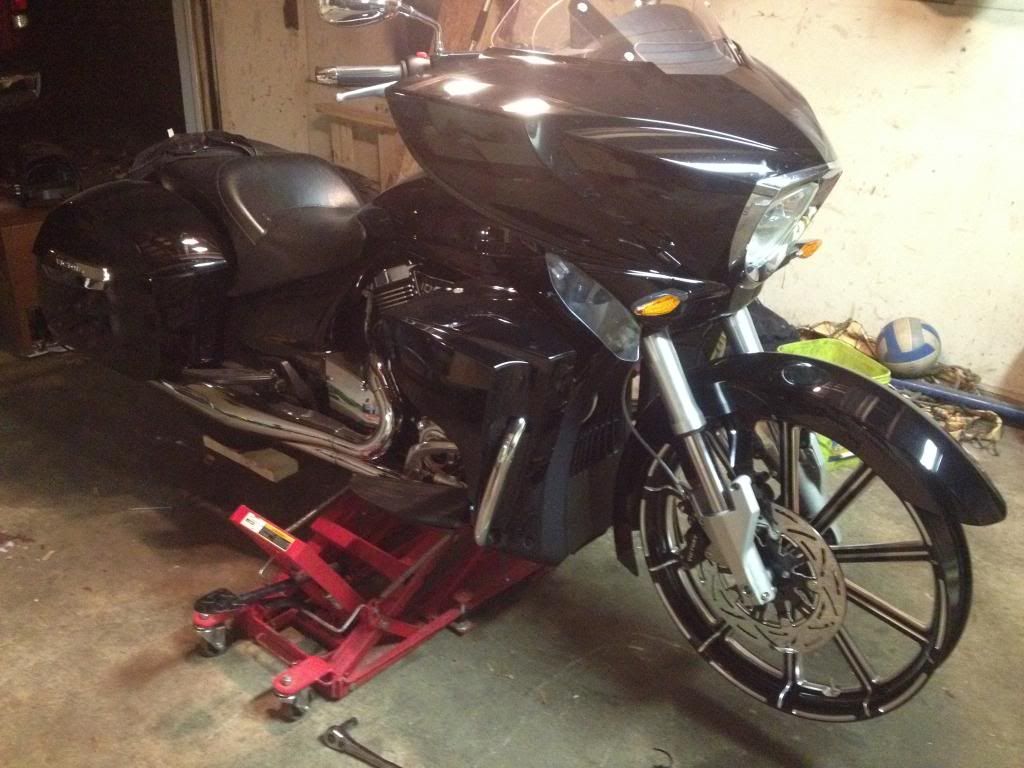

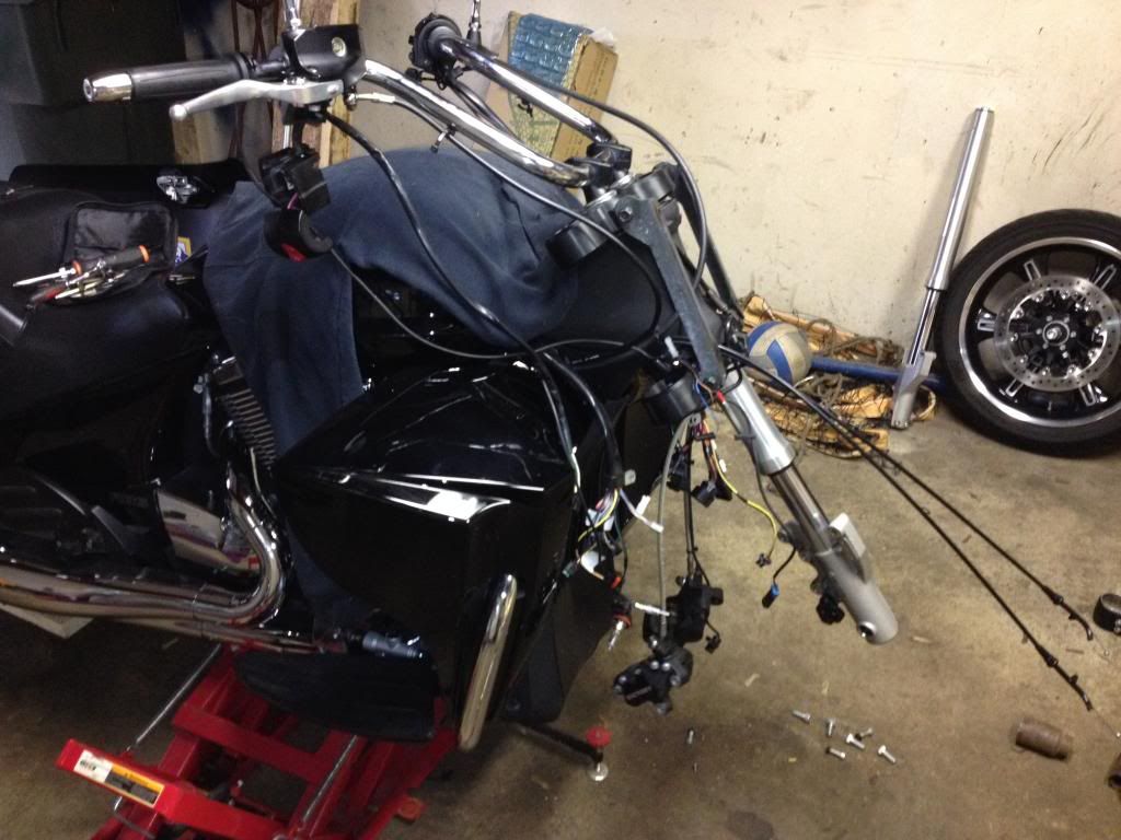

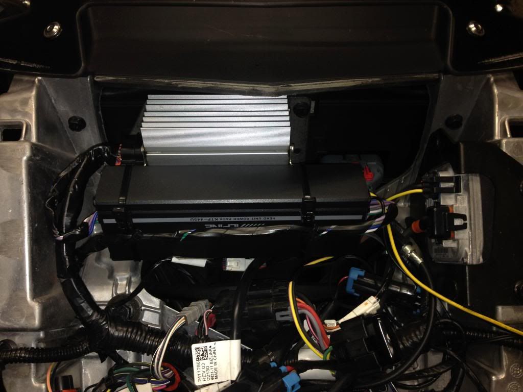

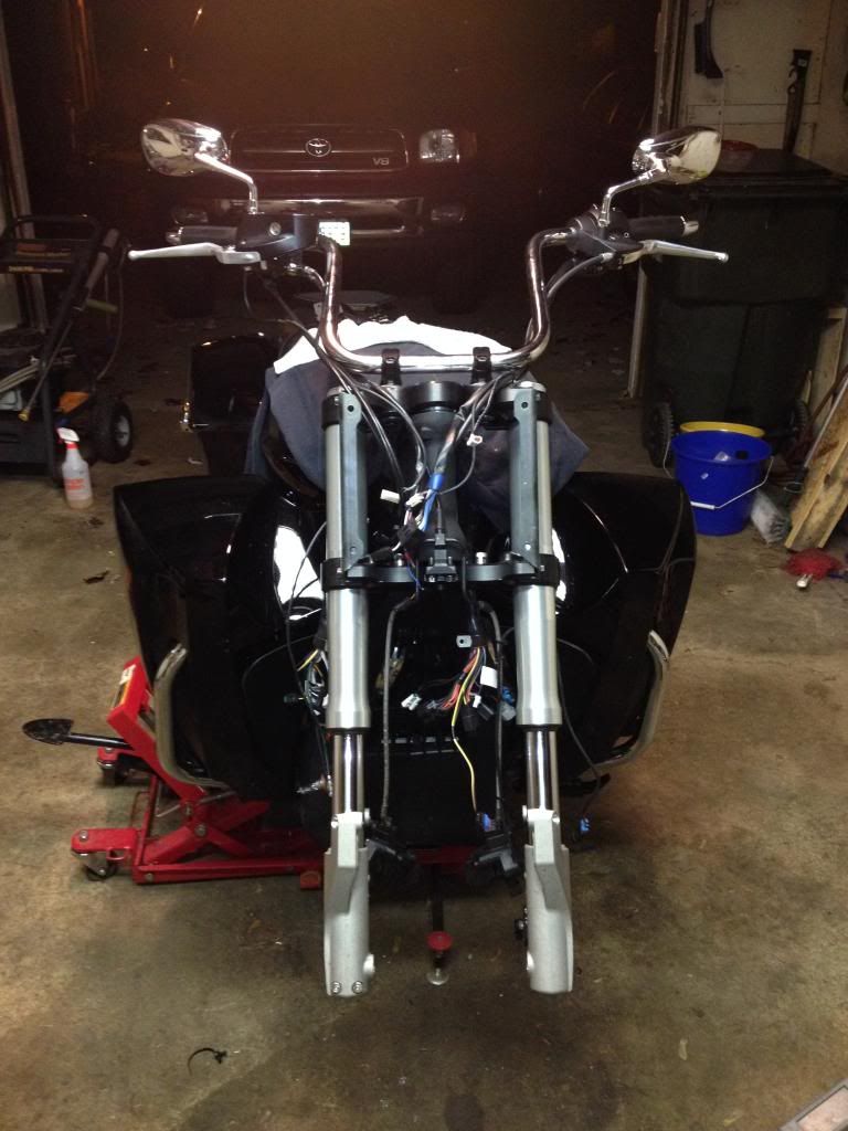

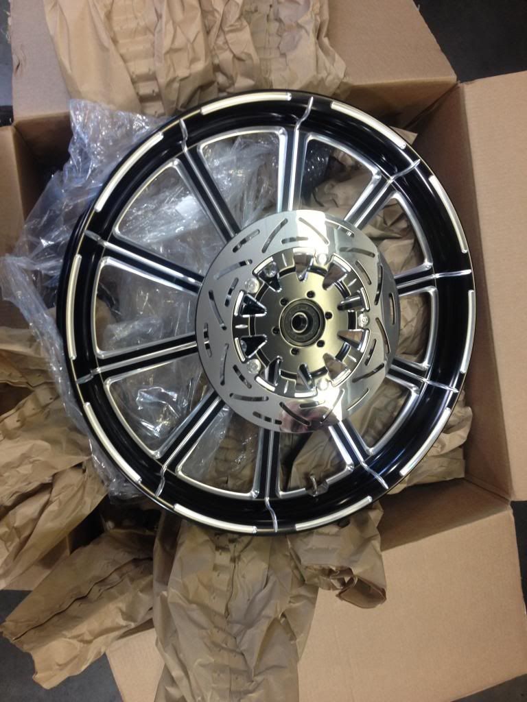

Last fall I decided it was time for upgrades. I installed an Arlen ness 23" front wheel, 6degree tripple clamps, fender, fork limiters, front brake rotors, and a new abs ring. Also since I had the front end apart I installed an amp and speakers

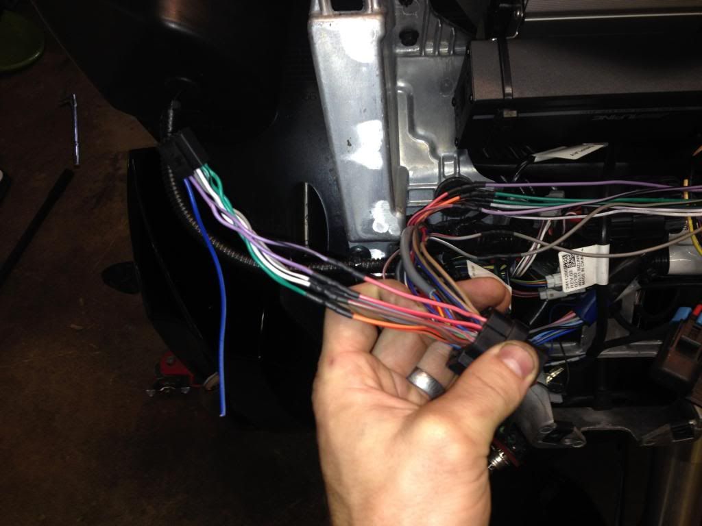

I had to splice into the factory harness to install the amp
Cleaned up and taped up
Arlen ness wheel

Very nice! Looking good man!

Looks like it turned out good, nice splice job on the wires, heat shrink is a must, thumb up, thought you forgot to put the tire on the wheel.:Dcheers

I'm a Toyota technician so I know my way around a toolbox and soldering wires. I need to disassemble the front forks and put a thicker fluid. Factory oil weight is 5w but I have bottomed out the front end 4 times while braking and driving over a bump. So I'm going to bump it up to 15w fork oil

when doing the front wheel, can you use the stock rotors?
