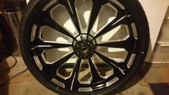

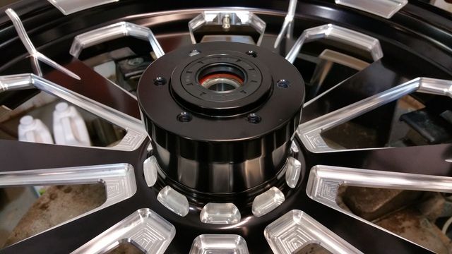

Ok guys I have a problem, I just picked up my new Victory billet 21" wheel & tire and my local Victory dealer doesn't have wheel changing equipment. I took it to another bike shop and they where hesitate to do the work because it doesn't have any markings on it for orientation no where on that wheel. So if anyone out their, that has the Victory billet wheel or knows how to determine the correct orientation please help me out. See pic's and tell me which side is left or rt as the wheel would be on the bike. I had them install the tire and I hope it's right you can just barley see the arrow on the tirein the last pic. see pic's.

Looking in my own service manual (2013) regarding billet front wheel assembly, the side with the bolts is located to the left side of the bike (as you are sitting on it) .. So, yes, the direction of tire travel arrows, seem correct..

The shop I went to wasn't a Victory shop, so they had no info on how to determine the orientation of the rim it self! So to be clear, in the third pic that is the left side when orientated to the bike?

Looks like the dot on the tire is about 90 degrees off from where it's supposed to be lined up with the valve stem-must have been a rookie that mounted the tire?

How important is that, to have the dot line up with the valve stem? I'm not trying to be funny, I'm asking cause I don't know and if it's for a safety reason our for alignment purpose I'll take it back and have them correct it.

It's a balance thing-probably not a big deal. It just shows a lack of attention to detail on the tire tech's part.
It looks like I have that right.. Again this is from my 2013 Service Manual - See Diagram Below cheers

Some tire have dots some tires don't.
The dot is a starting point to put by valve stem. Then you spin balance tire to find heavy spot. Now you break the bead on the tire and move the dot to where the heavy spot is.
Wheels don't have a direction to them like a tire does. BUT once you do run it always keep the right side on the right cause that's the way the wheel bearing have seated in
