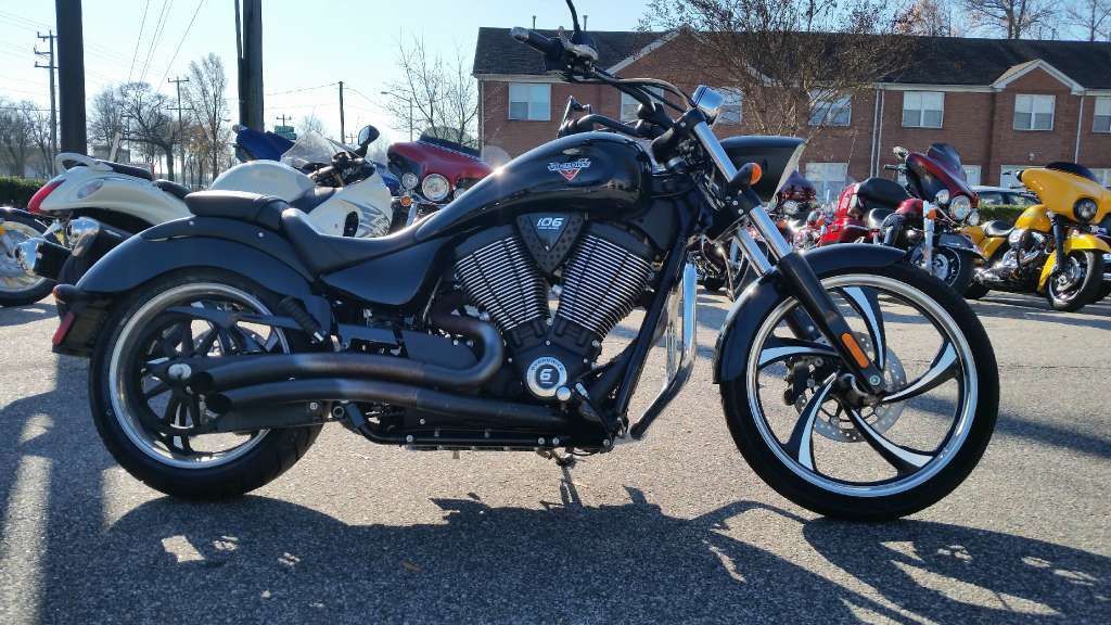

Looking at picking up a 2013 vegas 8 ball with 3900 miles on it tomorrow. it has the x box exhaust system already on it which if I bought a brand new one would have it put on. my question is should I be worried about the exhaust being burnt like this or is that normal of this system?

Wow that must have gotten hot... I don't think those are the Xbow's. They look to short. I would be a little bit alarmed by that exhaust being that burnt. Not so much the head pipes as the muffler portion.

I am taking a wild ass stab in the dark here but my guess is that thing was running crazy lean at one point.

oh good eye. I thought they were the x bow's thanks for pointing that out. have a test ride scheduled for tomorrow what would cause the exhaust to get burnt like that.

It could be faulty coating on the pipes... Or it could be that bike is running really lean and getting really hot because of it! If it's running that lean I wouldn't pay very much money for it.

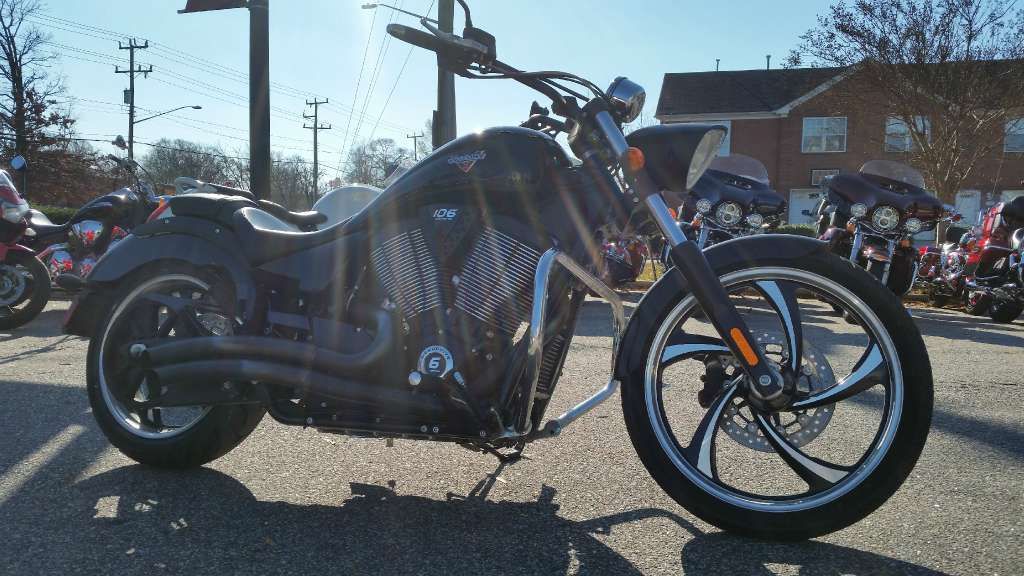

They are asking 8400 for it. Zoomed in on the pics and looks like the the middle of the pipes have an exhaust leak right there. What would cause it to run lean? Will a programmer fix that?

Fuel Controller would definitely fix that... If the pipes have been changed and no fuel controller was added the damage could already be done. It got so hot it cooked the coating off the heat shields I see... I don't know man but I am thinking I would low ball the hell out of them on this bike. Even if there is nothing wrong with it engine wise you need to spend $1500 on it right out of the gate. New pipes $750, fuel controller $350 plus install and dyno tune or auto tune.

Yeah tread real carefully with that. Those burnt up pipes are a flashing red light warning sign.
Things to ask--
Who did the pipes? If he claims dealer or other "expert"- where's the documentation? Docs should verify that they loaded a new software map. If there is no controller installed, and he has no proof he loaded a map that works with those pipes- It may be best to assume that a serious and prolonged lean condition existed. This can be very damaging.
I'm kind of swinging wild here- maybe sniff around (literally) for burnt oil? Check the dipstick. Any smoke on startup? I would advise to be ready to walk on this bike if you have the slightest doubt.

If its from running excessive lean the exhaust valves will be burnt töo and ready to let go.
Just as well it wasnt covered up with VHT header paint.
Its a big danger sign to me.
Id at least pull the spark plugs cos if they haven't bothered hiding the exhaust signs then you may find signs of lots of heat on the spark plugs.
Compression check will show up burnt valves.
Be real careful

Yeah. Look man. Victory makes a damn near bulletproof machine. But this thing looks messed up. I have to agree- pass on this one. Regardless of historical quality - they need competent basic care. A hack exhaust job like this does not indicate competence. It would SUCK to have you or anyone have a terrible Victory ownership experience and leave you with a terrible taste and never buy again..
There's got to be another one out there for you or possibly take advantage of winter pricing and incentives on a new one..
