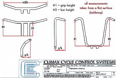

If that doesn't work, most motorcycle handlebars are measured like the photo below (borrowed from Nash Motorcycle Company).
- The 7.5" and 9.5" dimensions are the inner and outer clamp area.
- The 12" measurement is the height.
- The 31" measurement is the overall width.
- The 9" measurement is the grip length.
The only other dimension that you'll need and the above photo doesn't show is the pullback. This photo shows how to measure that - the "p/b" dimension.
