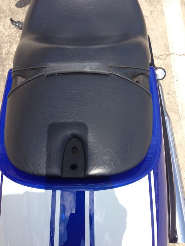

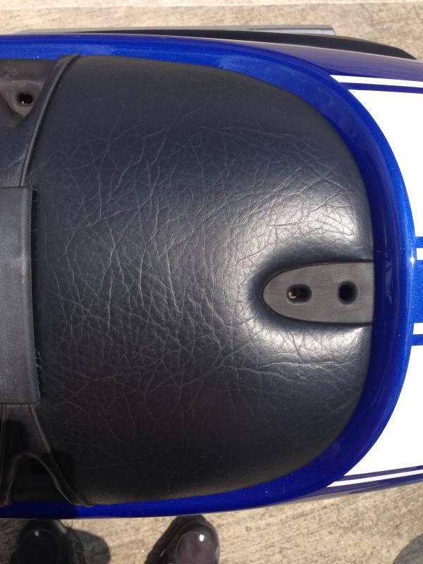

My 2009 HS I got with a 2 up Victory Touring seat and in my opinion this ride looks nicer with the Cowl on and with the 250 rear, it's just meant to be riden 1 up. So I got the OEM Cowl seat for $100 and switched it back...here's how;
The Touring seat has 4 bolts that bolts on from under the rear fender, I removed the 4 11mm head bolts and pulled the seat upwards to the rear and off it came, here you can see the 4 bolt holes;

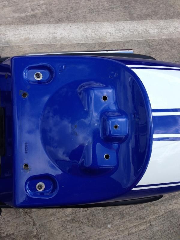

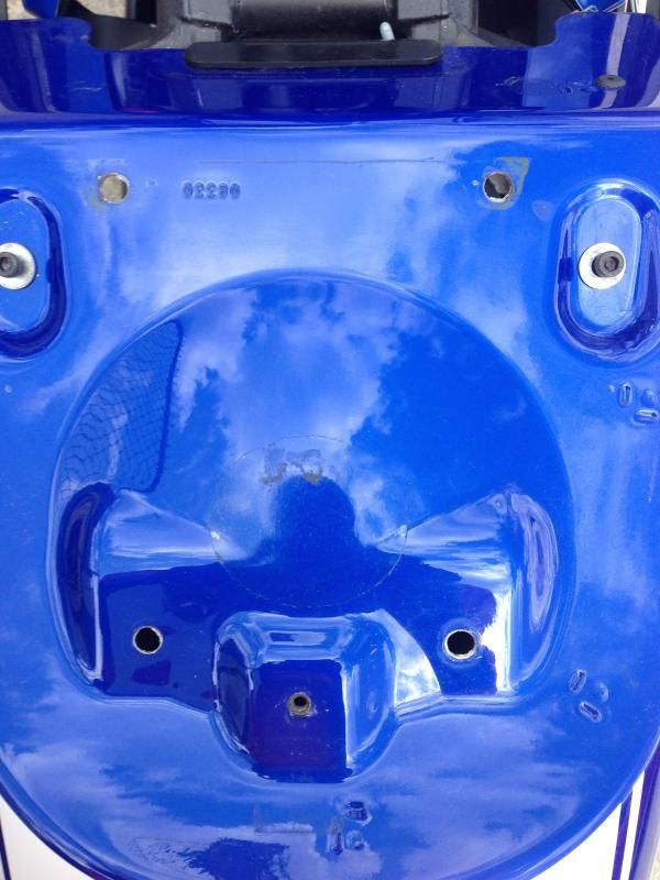

the 4 bolts in them

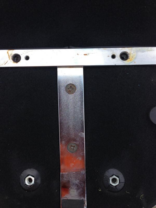

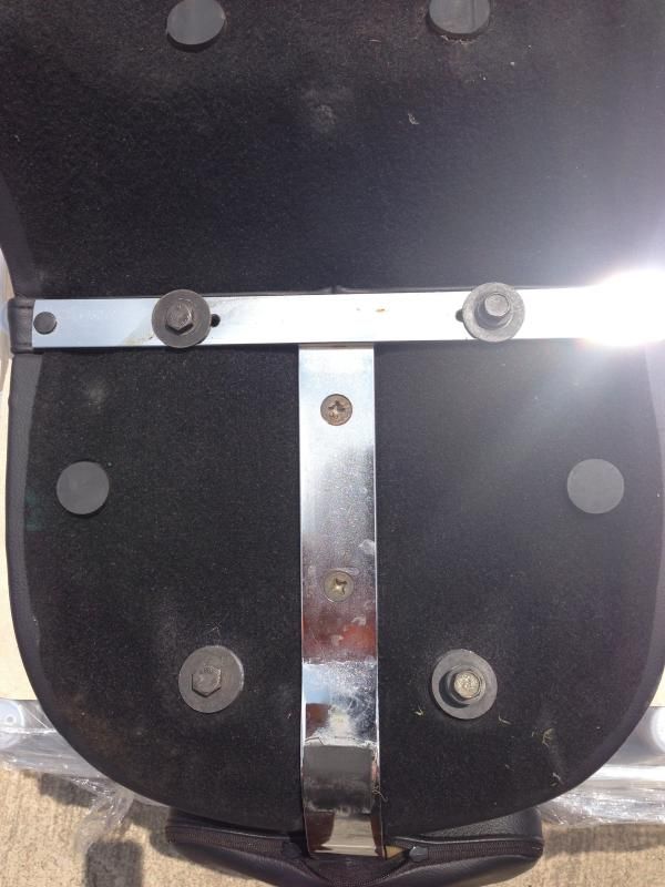

I realized that they had to drill the four holes into the fender in order to mount this Touring Seat, the OEM seat has only 3 6mm Allen Head Bolts to mount the seat...here you see the 2 allen head bolts and the third one is in the rear of the Cowl seat;
I placed the OEM seat with the front tab first behind the gas tank and lined up the three holes starting the rear allen head bolt first by feeding an allen wrench through the rubber grommet leaving it threaded and lose, then threading in the two side allen head bolts, then tightening all three down and your done;
