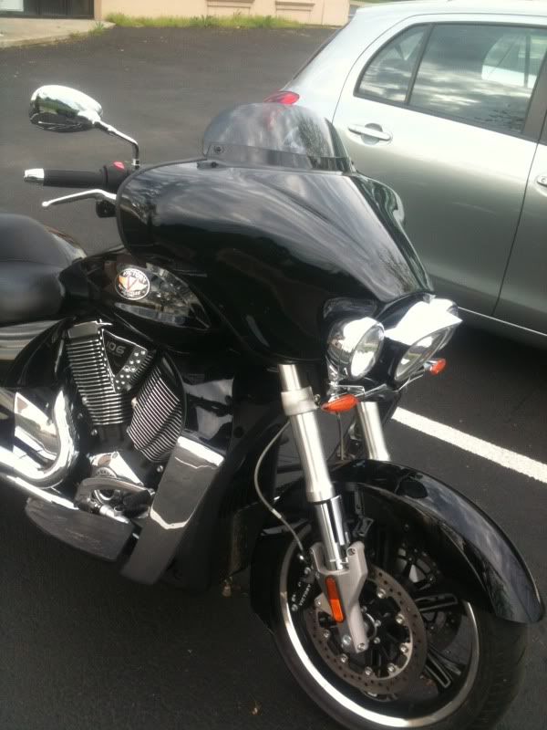

I love it. It's a whole new bike. Adds some width to the front matching the ass end. Certainly is a head turner. Still get some wind but no buffeting.
See less See more
That looks really good. Is that the stock windshield height? Like I said, I haven't looked into this a whole lot yet, but I like what I've seen so far.
Yes that's the shield that comes with the fairing.
